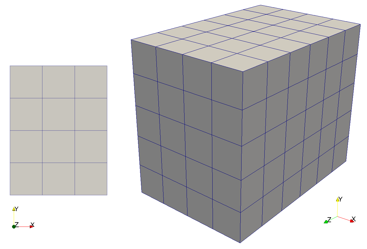

Examples
  • To generate a simple 2-dimensional mesh measuring 3 by 4 length units call
> bin/generateStructuredMesh -o quad_3x4.vtu -e quad --lx 3 --ly 4 ⏎
info: Mesh created: 20 nodes, 12 elements
  • To generate a simple 3-dimensional mesh measuring 4 by 5 by 6 length units call
> bin/generateStructuredMesh -o hex_4x5x6.vtu -e hex --lx 4 --ly 5 --lz 6 ⏎
info: Mesh created: 210 nodes, 120 elements.
Resulting mesh

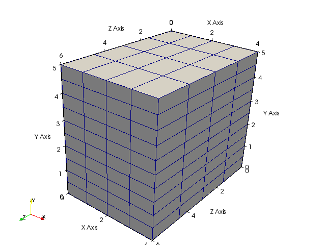

Hexahedral mesh as above but with 10 elements in y-direction and element length of 1.5 in z-direction:
> bin/generateStructuredMesh -o hex_4x5x6.vtu -e hex --lx 4 --ly 5 --lz 6 --ny 10 --dz0 1.5 ⏎
info: Mesh created: 275 nodes, 160 elements.
Resulting mesh

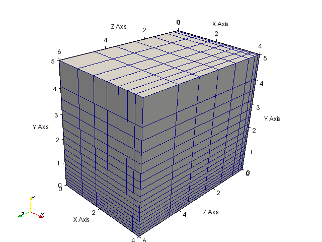

Hexahedral mesh as above but with three different non-uniform mesh refinements:
  • x-direction: Element shrinking (growth factor < 1) starting with default element length 1.
  • y-direction: Element growth (factor 1.1) starting with specified element length 0.1.
  • z-direction: Fast element growth (factor 2) starting with specified element length 0.1 and limited by maximum length 1. (The last element is larger than maximum because of the gap to be filled for the given mesh length as described in uniform-mesh refinement section.)
bin/generateStructuredMesh -o hex_4x5x6.vtu -e hex --lx 4 --ly 5 --lz 6 --mx 0.8 --my 1.1 --dy0 0.1 --mz 2 --dz-max 1 --dz0 0.1 ⏎
info: Mesh created: 1368 nodes, 1008 elements.
Resulting mesh
