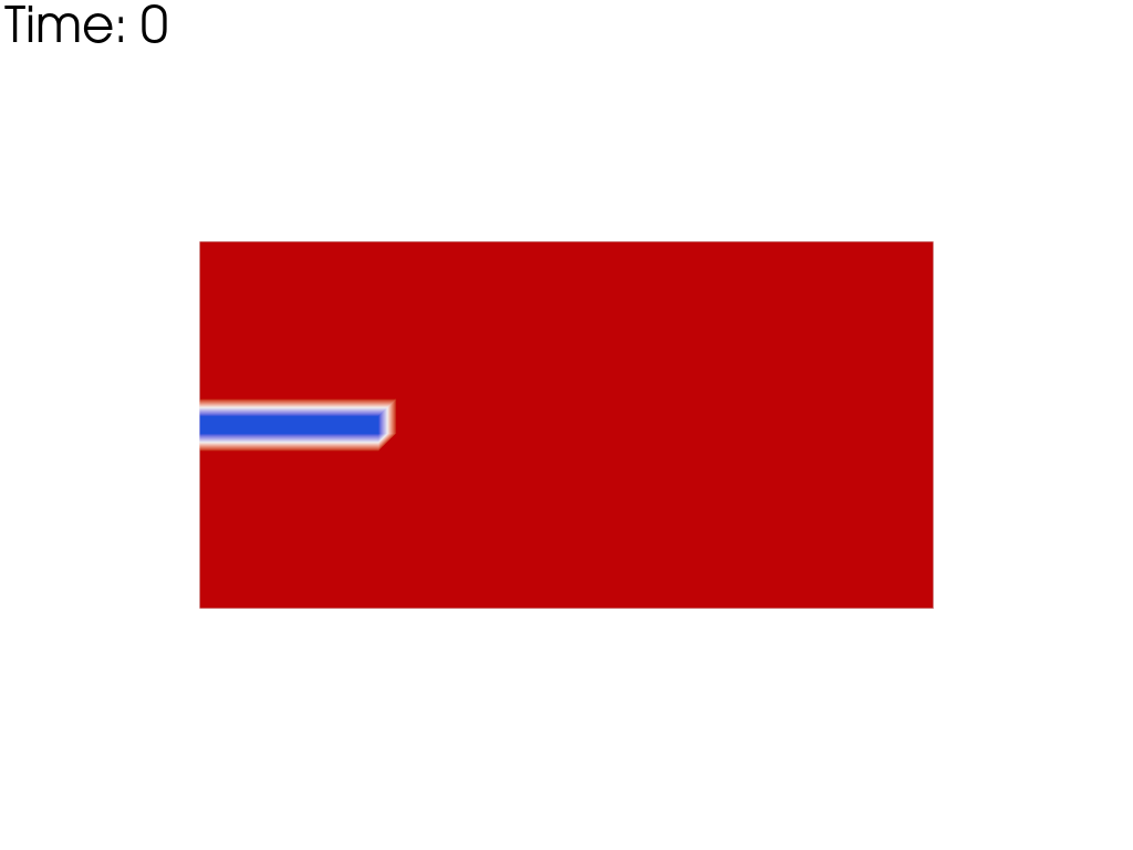

Pre-processing
At fracture, we set the initial phase field to zero.
pv.set_plot_theme("document")
mesh = pv.read(f"{out_dir}/surfing_quad_1x2_NR.vtu")
    if (
        x[0] < x_tip_Initial + h / 10
        and x[1] < Height / 2 + h
        and x[1] > Height / 2 - h
        phase_field[node_id] = 0.0
mesh.point_data["pf-ic"] = phase_field
mesh.save(f"{out_dir}/surfing_quad_1x2_NR_pf_ic.vtu")

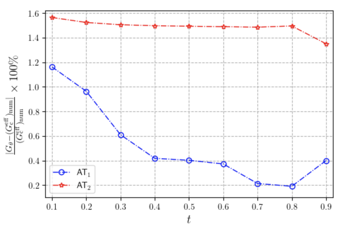

Plots
plt.xlabel("$t$", fontsize=14)… (click to toggle)
plt.ylabel(
    r"$\frac{|{G}_\mathrm{\theta}-({G}_\mathrm{c}^{\mathrm{eff}})_\mathrm{num}|}{({G}_\mathrm{c}^{\mathrm{eff}})_\mathrm{num}}\times 100\%$",
    fontsize=14,
plt.plot(
    G_theta_time[:, 0],
    abs(G_theta_time[:, 1]) / G_eff,
    "-ob",
    fillstyle="none",
    linewidth=1.5,
    label=f"Phase-field {phasefield_model}",
plt.plot(
    G_theta_time[:, 0],
    np.append(0, np.ones(len(G_theta_time[:, 0]) - 1)),
    "-k",
    fillstyle="none",
    linewidth=1.5,
    label="Closed form",
plt.grid(linestyle="dashed")
plt.xlim(-0.05, 0.8)
plt.ylabel(
    fontsize=14,
plt.plot(
    G_theta_time[:, 0],
    abs(G_theta_time[:, 1] - G_eff) / G_eff * 100,
    "-ob",
    fillstyle="none",
    linewidth=1.5,
# plt.ylim(0,4)
Hint: Accurate results can be obtained by using the mesh size below 0.02.
