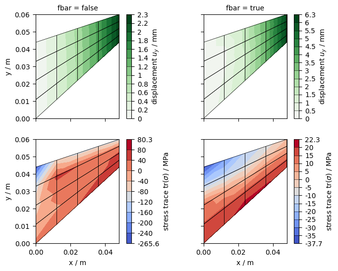

Result

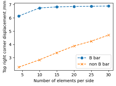

The following figure shows that the convergence of the solutions obtained by using the F bar method follows the one presented in the paper by T. Elguedj et al [1]. However, the results obtained without the F bar method are quit far from the converged solution with the finest mesh.
fig, ax = plt.subplots(figsize=(4, 3))… (click to toggle)
ax.plot(n_range, np.asarray(uy_top_fbar_true) * 1e3, "--o", label="B bar")
ax.plot(n_range, np.asarray(uy_top_fbar_false) * 1e3, "--x", label="non B bar")
ax.legend()
Comparison of results

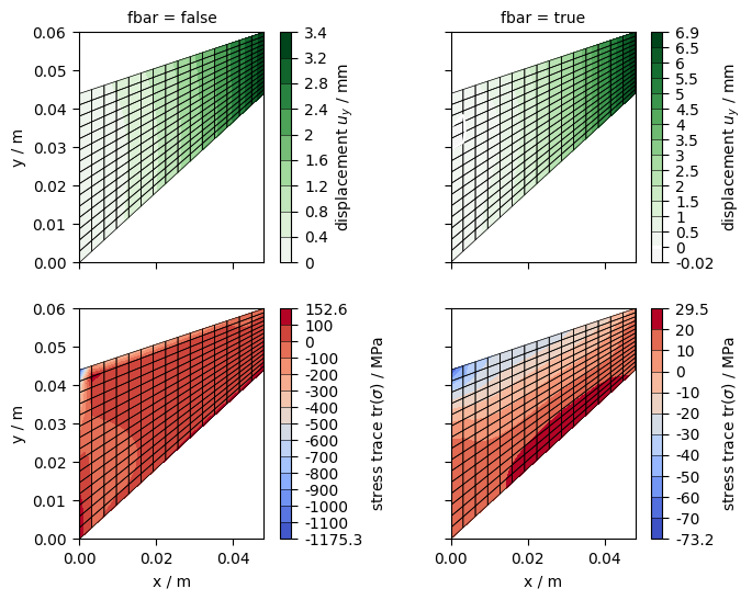

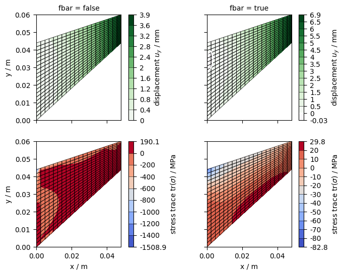

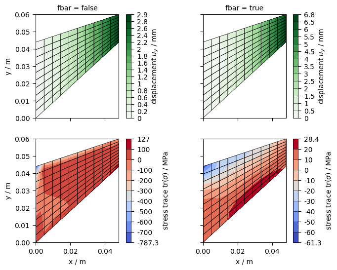

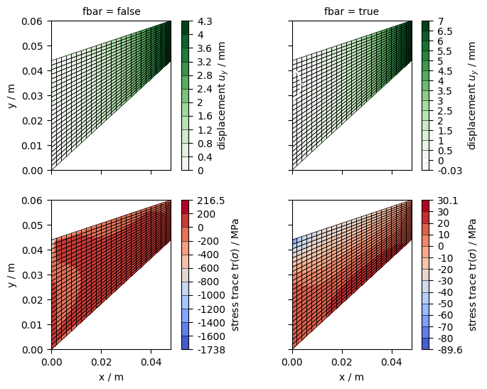

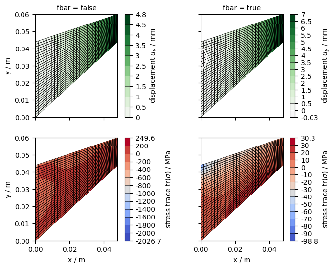

The contour plots show that even with the coarsest mesh, the F bar method still gives reasonable stress result.
for n in n_range:
    compare(results_fbar_false[n][-1], results_fbar_true[n][-1])
