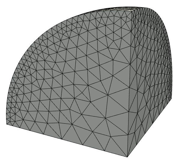

This is a classical example to demonstrate the effect of hydromechanical coupling in a poroelastic medium. For more details we refer to a textbook (Verruijt, 2009), in which also the analytical solution is derived. As domain we consider a sphere, by symmetry we need to simulate only an octant.
Domain Mesh
Mesh

Radius $0.4$ m
Finite Elements $8741$ Taylor-Hood tetrahedra
