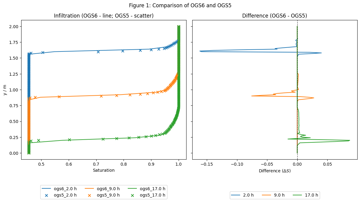

The simulated and experimental saturation data at various time steps are plotted in Fig.1. The OGS6 simulated infiltration front propagates through the soil column and resembles well the saturation results of OGS5.
To ensure the consistency of different interpolation functions, the soil column has been discretized by two dimensional geometrical models, which contain accordingly consistent finite element types such as triangles or quadrilaterals. Fig. 1 shows the saturation contours after 2, 9 and 17 hours for structured meshes.

fig, (ax1, ax2) = plt.subplots(1, 2, figsize=(12, 7), sharey=True)… (click to toggle)
ms = ot.MeshSeries(out_dir / "richards.pvd").scale(time="h")
ms_ogs5 = ot.MeshSeries("h_us_line_Warrick/h_us_line_Warrick_RICHARDS_FLOW.pvd").scale(
    time="h"
# Define shared resolution and colors
res = 200
color = ["C0", "C1", "C2"]
mesh_pairs = [(1, 7), (2, 8), (3, 9)]
for i, (ogs6, ogs5) in enumerate(mesh_pairs):
    line6 = ms.mesh(ogs6).sample_over_line([0.02, 0, 0], [0.02, 2, 0], resolution=res)
    sat6 = line6["saturation"]
    y_coords = line6.points[:, 1]
    line5 = ms_ogs5.mesh(ogs5).sample_over_line([0, 0, 0], [0, 0, 2], resolution=res)
    sat5 = line5["SATURATION1"]
    ax1.plot(sat6, y_coords, c=color[i], label=f"ogs6_{ms.timevalues[ogs6]} h")
    ax1.scatter(
        sat5,
        y_coords,
        c=color[i],
        marker="x",
        label=f"ogs5_{ms_ogs5.timevalues[ogs5]} h",
    difference = sat6 - sat5
    ax2.plot(difference, y_coords, c=color[i], label=f"{ms.timevalues[ogs6]} h")
ax1.set_xlabel("Saturation")
ax1.set_ylabel("y / m")
ax1.set_title("Infiltration (OGS6 - line; OGS5 - scatter)")
ax1.legend(loc="lower center", bbox_to_anchor=(0.5, -0.3), ncol=3)
ax2.set_xlabel(r"Difference ($\Delta S$)")
ax2.set_title("Difference (OGS6 - OGS5)")
ax2.axvline(0, color="black", linestyle="--", linewidth=1, alpha=0.7)  # Zero Reference
ax2.legend(loc="lower center", bbox_to_anchor=(0.5, -0.3), ncol=3)
fig.suptitle("Figure 1: Comparison of OGS6 and OGS5")
plt.tight_layout()
